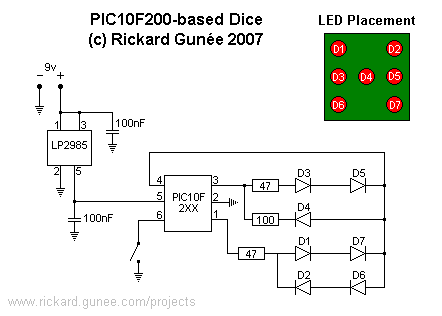

Project Specifications
  • PIC:PIC16F200
  • LED Type:LED SMD x 7
  • Dice Patterns:6

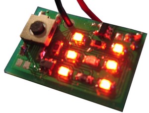

Circuit random 1 to 6 output like a dice.
Can be used PIC10F222
Roll animation dice animation
LP2895 is a 5v regulator, can be replace by other regulator.
all circuit is maded with smd devices, however, can be used another type.
Circuit Diagram, PCB
Electronic circuit diagram - Dice
dice electronic schematic

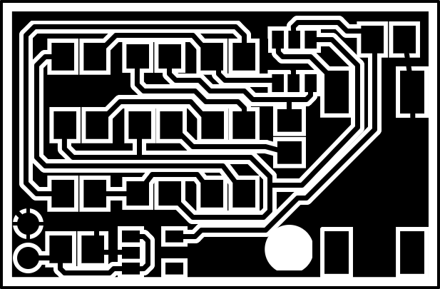

Electronic Dice PCB
Pattern drawing (component side)

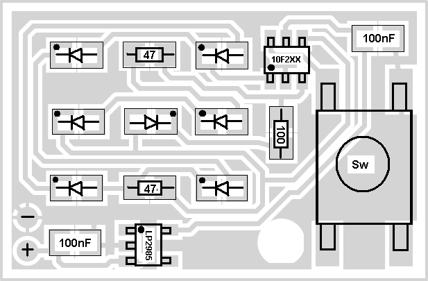

PCB components layout
PCB layout
