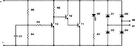

You can use either direct current (up to 2 A and 20 Vdc) as alternating current (up to 3.5 A AC and 15 VDC). Replaces conventional fuses.
Component | Type-Value |
D1, D4 | 1N5404 |
D5 | RED 5mm |
T1 | TIP41 - Transistor |
T2 | BC337/2A - Transistor |
T3 | BC548/2A - Transistor |
R1, R2 | 1 Kohm - Resistor |
R3 | 10 Kohms - Resistor |
R4 | 33 Kohms - Resistor |
R5 | 47 Kohms - Resistor(see note) |
C1 | 4,7 nF - Capacitor |
L | Heatsink L type |

The circuit values are calculated for a voltage of 20 volts. The R5 value depends of max current used.
- 600 mA R5=47 Kohms
- 1,8 A R5=56 Kohms
- 3,3 A R5=68 Kohms
