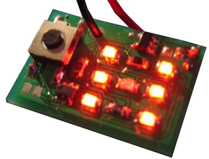

Project Specifications
- PIC:PIC16F200
- LED Type:LED SMD x 7
- Dice Patterns:6

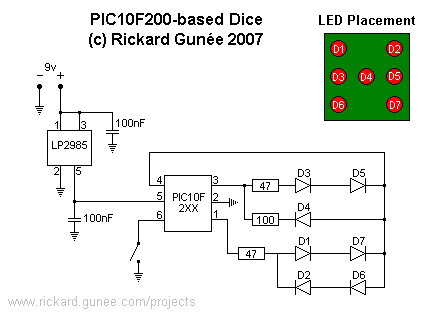

Circuit random 1 to 6 output like a dice.
Can be used PIC10F222
Roll animation | ![]() |
LP2895 is a 5v regulator, can be replace by other regulator.
all circuit is maded with smd devices, however, can be used another type.

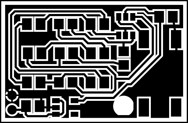

Circuit Diagram, PCB
Electronic circuit diagram - Dice

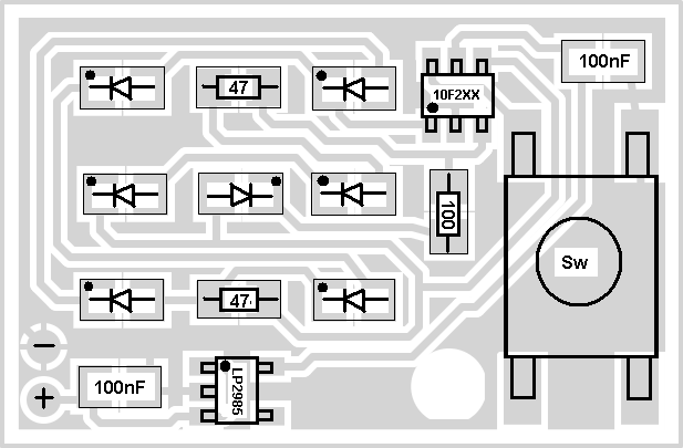

Electronic Dice PCB
Pattern drawing (component side)
