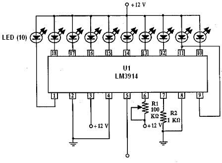

Battery Monitor with LM3914
This circuit uses the LM3914 integrated circuit to display battery voltage levels on a series of LEDs in either bar or dot mode. It provides a visual indication of battery charge status, making it ideal for monitoring 12V or other low-voltage batteries.
Circuit Operation
  • The LM3914 senses the battery voltage and lights up 10 LEDs proportionally, forming a bar or dot display depending on the mode selected.
  • Each LED corresponds to a voltage step, providing an intuitive visual representation of the battery charge.
  • The reference voltage and LED mode can be adjusted to match different battery types and voltage ranges.
Key Features
  • Displays battery voltage level with 10 LEDs
  • Selectable bar or dot display mode
  • Simple, compact, and reliable design
  • Adjustable reference voltage to match battery type
  • Works for 12V batteries or other low-voltage applications
Construction Notes
  • Use low-tolerance resistors for the voltage reference to ensure accurate LED display steps.
  • Connect LEDs with correct polarity; the IC sinks current, so LEDs connect from +V to output pins.
  • Keep battery input wiring short and avoid interference for accurate readings.
  • Optionally, add a series resistor for each LED to adjust brightness or protect the LEDs.
battery monitor
Ref.Components
U1LM3914 Bar Dot Generator IC
R1100KΩ potentiometer
R21KΩ resistor
LED1-10light emitting diodes (LEDs)
