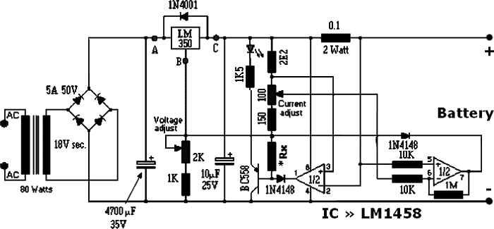

This charger is designed for 12V motorcycle batteries and uses the LM1458 dual operational amplifier to regulate the charging process. The circuit provides a safe and automatic charge for lead-acid batteries.
  • Transformer: 80 W, 18V AC secondary
  • Rectification and filtering supply a DC voltage suitable for charging a 12V battery.
Circuit Operation
  • The LM1458 amplifies and monitors the battery voltage.
  • When the battery voltage is below the set threshold, the charger provides full charging current.
  • Once the battery reaches the preset voltage, the circuit switches to a low-current float mode to maintain the charge safely.
Key Features
  • Automatic charging for 12V motorcycle batteries
  • Float charge to maintain battery without overcharging
  • LM1458 dual op-amp for voltage monitoring and regulation
  • Suitable for lead-acid and gel batteries
  • Simple, compact, and reliable design
Construction Notes
  • Use a suitable heatsink for any power transistors or regulators handling charging current.
  • Ensure correct polarity when connecting the battery to prevent damage.
  • Include a fuse on the supply line for safety (typically 3–5A for motorcycles).
  • Monitor initial charging to confirm proper voltage adjustment before leaving the charger connected permanently.
