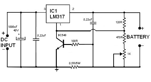

Adjust 1K POT to get the required charging current. Charging current = (1/10)*Ah value of battery.
Input on pin 3 of LM317 must be at least 15V to get 12 V for good battery .
Use heatsink in LM317.
